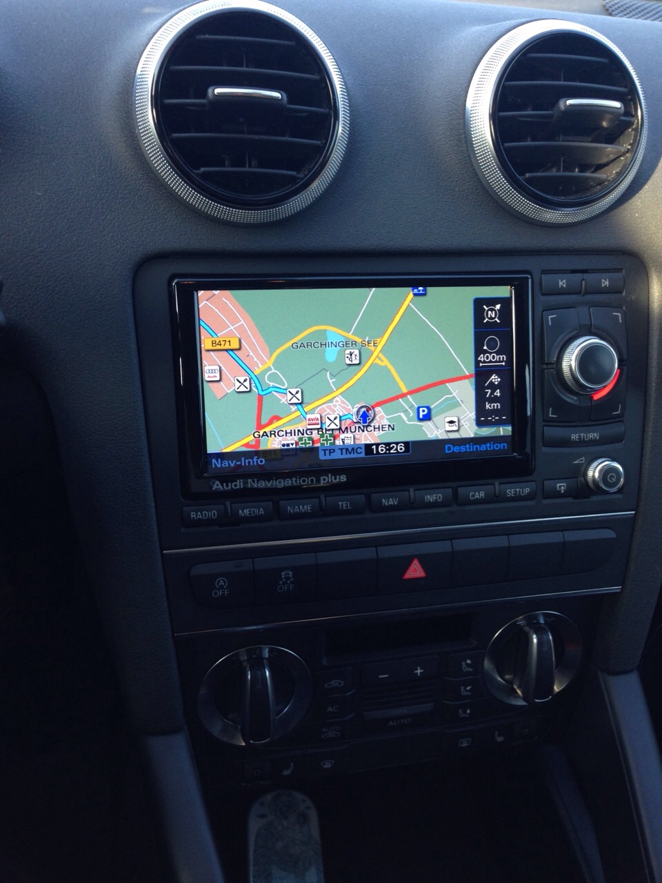

I hope there is no problem because I write in English, but in this moment I don't speak so well German. My name is George and I live in Munchen. Since one month ago I am the happy owner of an Audi A3 sportback 2.0 TDI from 2010 with a RNS-E display. My question for you would be if you can tell me if I can install Rückfahrkamera on my car and if you can advise me where to go in the area of Munchen for instalation.

It's the RNS-E 193-G, i think only the "Audi R8 genuine parts", which means the original camera and interdace from audi will work. The Audi R8 is available from factory with a rearview-camera. @Devender, or do have you another soloution?
Best regards
You are right, it is a 193. :frowning:
My Workshop will help only for 192 Modell.
Sorry my fault. I did not zoom the picture on my mobilephone.
