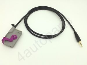

Got the Aux to work, Unfortunately i couldn't code so had to buy a Cable (attachment)
Thanks again for your Support.
